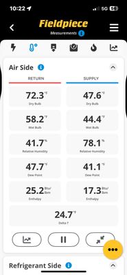

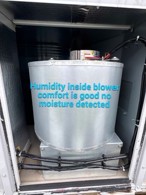

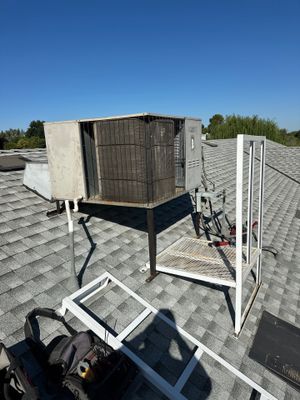

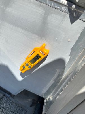

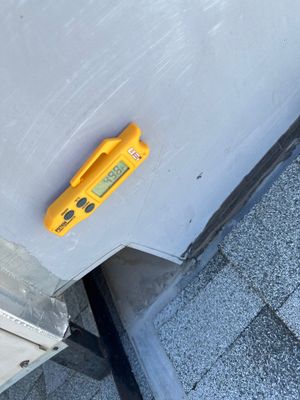

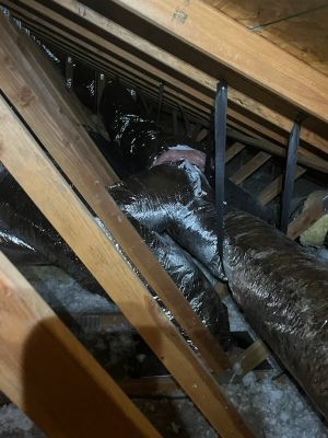

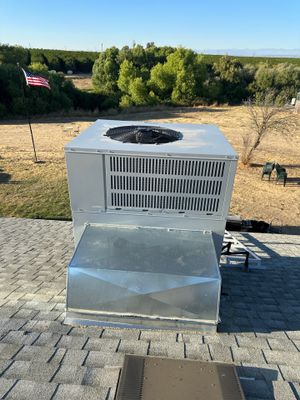

Air flow diagnostics after making necessary adjustments

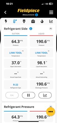

Refrigerant circuit readings after making necessary adjustments

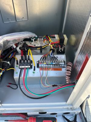

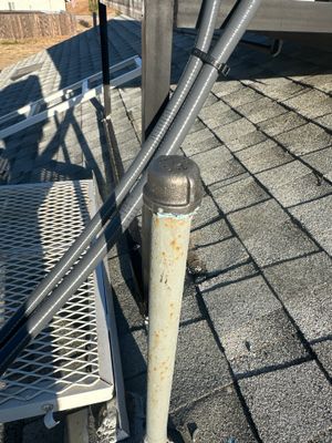

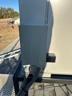

Secured with metal and screws

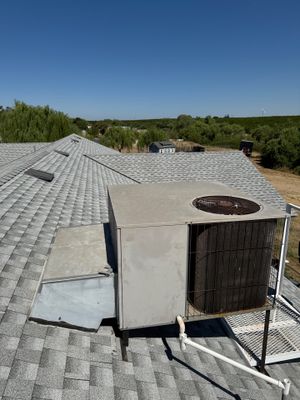

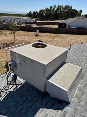

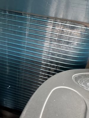

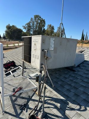

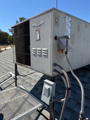

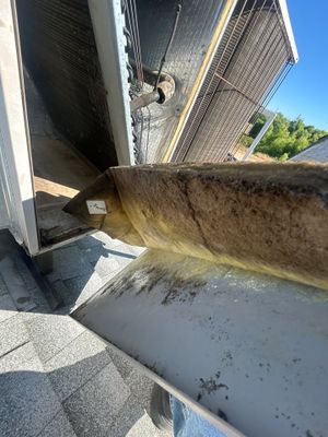

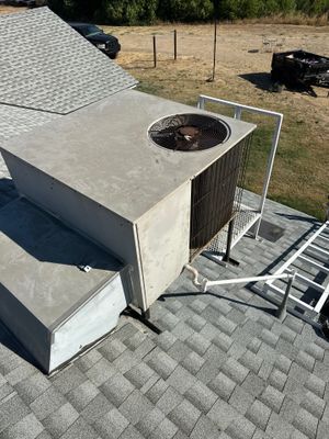

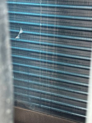

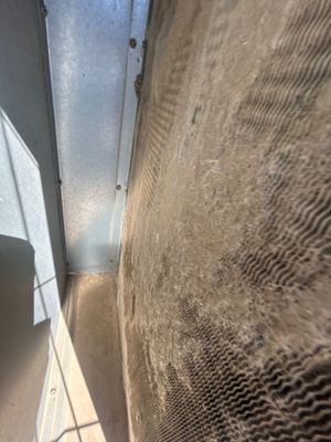

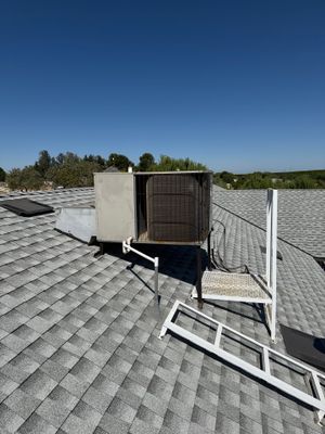

Wrap around portion of condenser coil on back of coil is severely  impacted

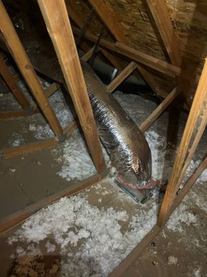

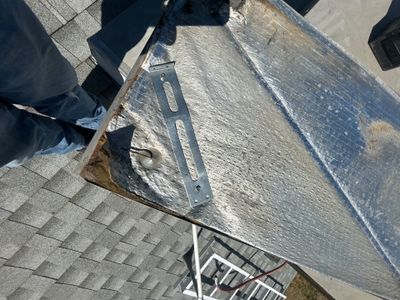

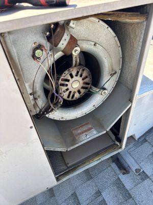

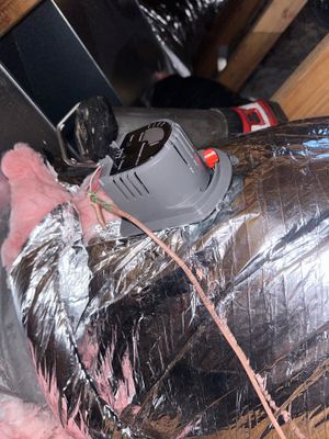

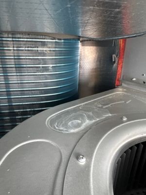

Insulation inside of panel loose. When blower is on it is pulled back and covers portion of evaporator coil

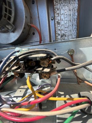

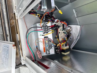

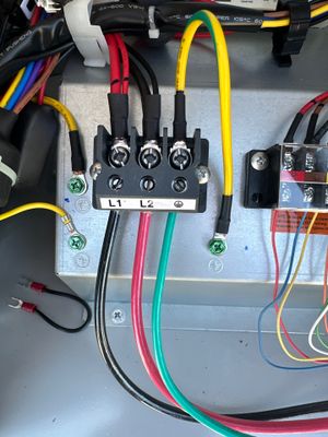

Pitting and burning contacter points

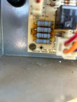

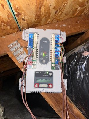

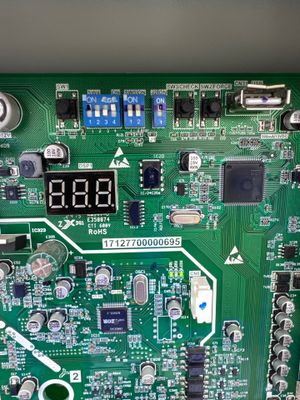

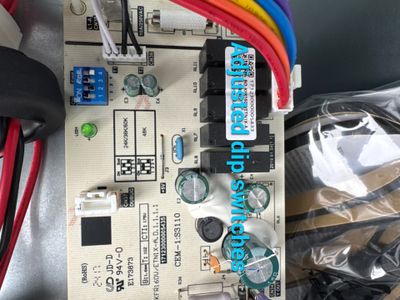

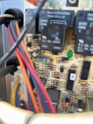

Signs of excessive heat on board

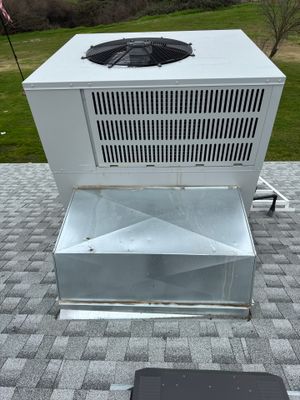

2025-07-03

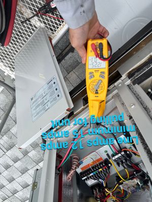

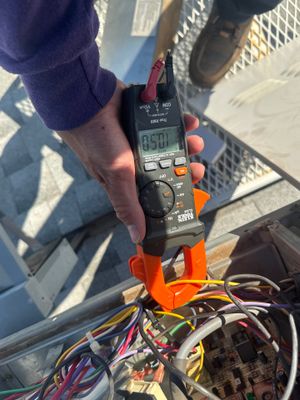

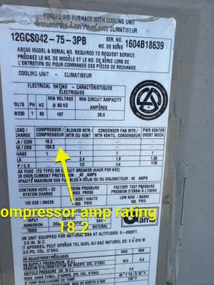

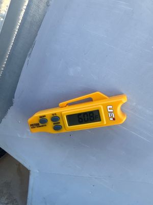

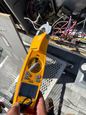

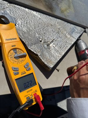

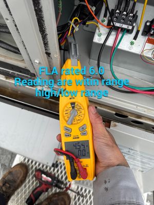

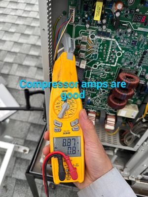

Compressor amps are
Good
Supply air 59 degrees indicating
Good delta T

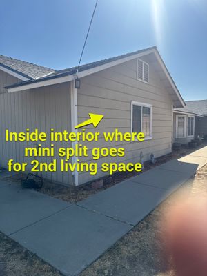

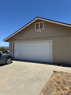

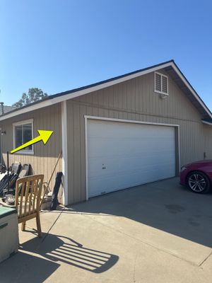

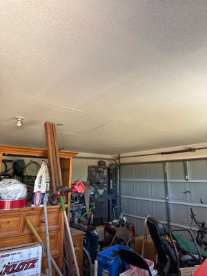

Mini split head possible needing two 9k heads
to cool/heat garage and second living space e

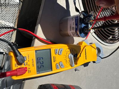

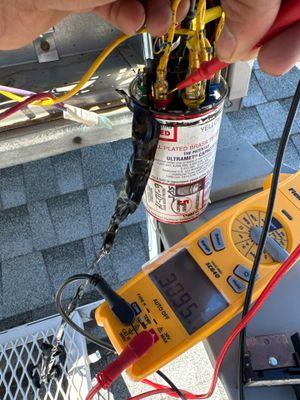

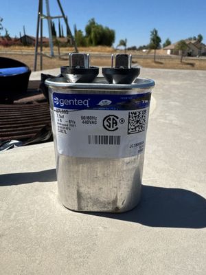

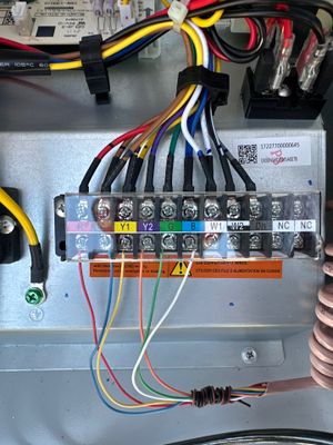

Change out cap

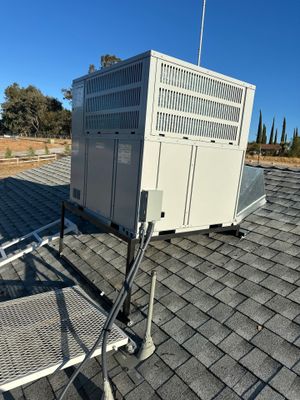

2025-06-11

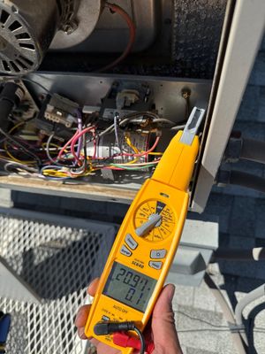

Supply
Return

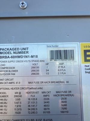

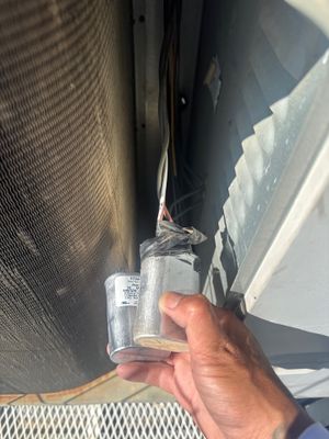

Condenser fan capacitor
Compressor

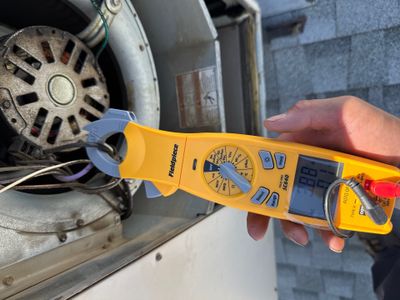

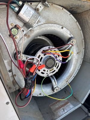

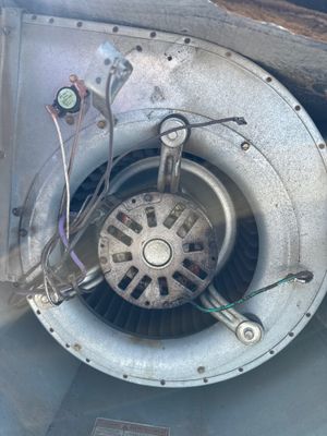

Indoor blower capacitor
1/2 blower motor

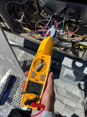

Indoor blower  max 3.4 reading 3.9
Reading are high recommend replacement
Condenser fan
Compressor
Amp draw for the load
